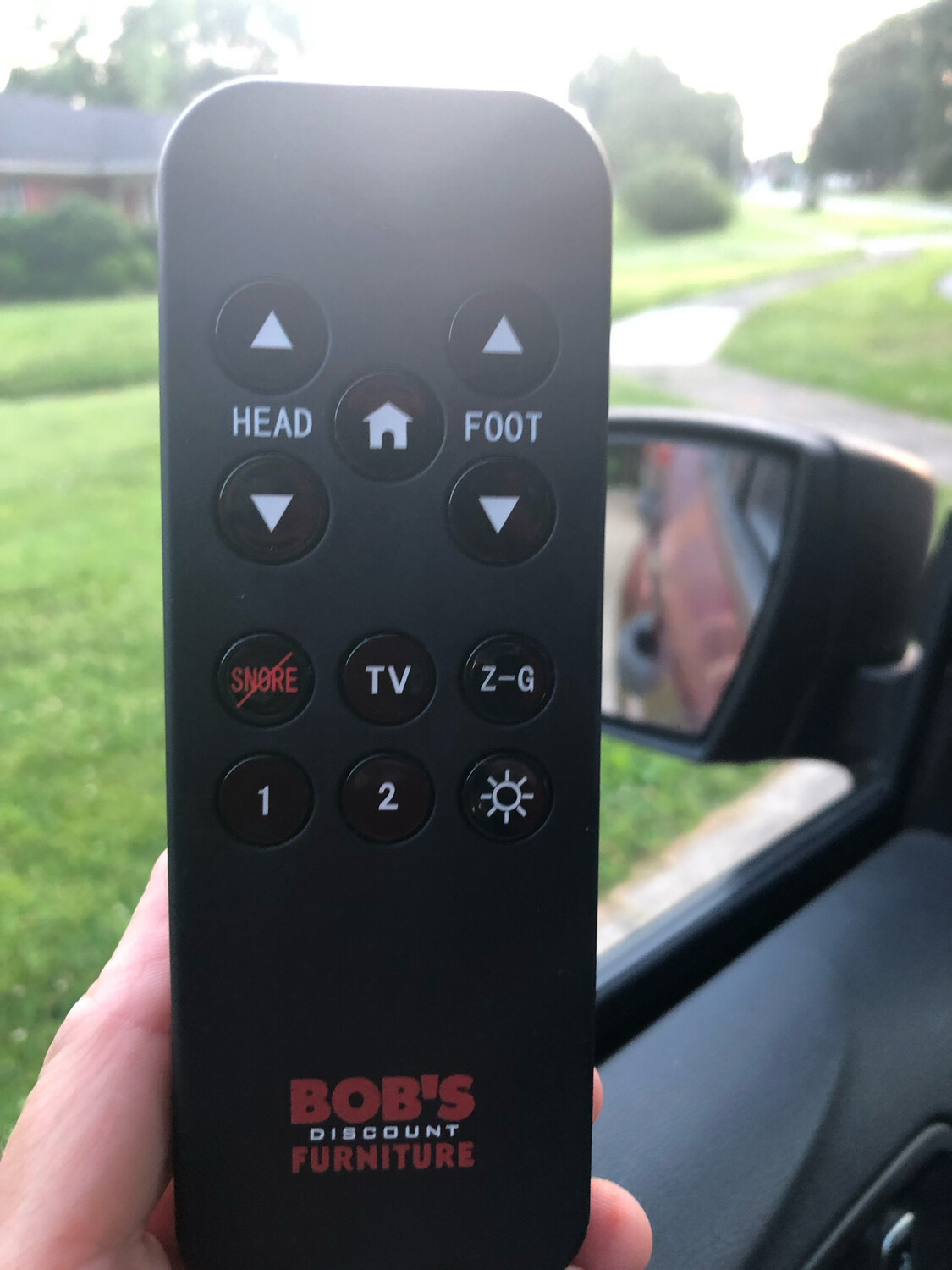

This universal kit converts old bed base control boxes with an easy-to-install 3 step process and includes a new wireless remote to control your bed base with advanced features like presets, one touch flat, and massage with three intensities and wave modes… even if your old bed did not have those features! (Note.. if your old bed did not have massage, that will not be an option on this new one either). Used to replace a lost or broken remote when there are no more replacements available or in budget or to upgrade a basic remote with only a few buttons.
